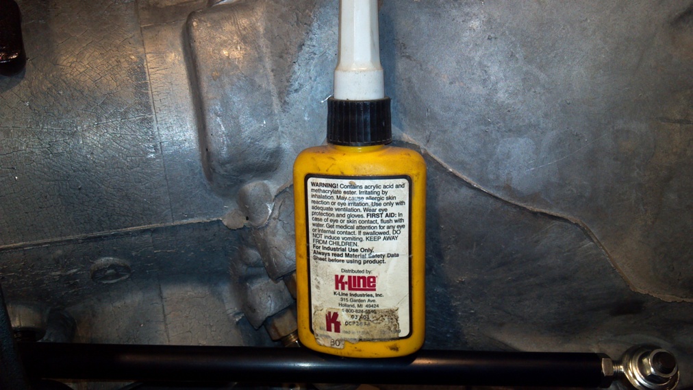

Does anyone know of a direct replacement for the sleeve and guide adhesive, sold by K-Line, under the name "Fushion"?
I've contacted K-Line and they said they had to place a huge order to get it. They have no intent on ever ordering a huge batch again.
This adhesive was unique in that it had excellent bond with excellent heat transfer. It's use required a clearance of roughly .002" between parts, rather than a press fit like current adhesives do. It also transferred heat, not blocked heat like current adhesives do.
Rumors have it that it was made by Loctite, but I've contacted Loctite (by email), and they know nothing about it. I'm sure it was a proprietary item.

Thanks for the link Tim, but those appear to be conveyor belt glues.
The product I am after is engine specific.

Fusion was a product that K-Line did offer for a while. It was a system that K-Line bought from another company, not developed by K-Line. It was a great product if all the steps were followed. It is something they haven't had in at least 11 years. The actual Fusion adhesive was packaged by Loctite, but was proprietary to K-Line.
