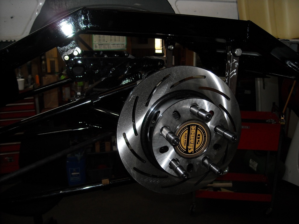

Old 01-02-2015, 11:07 PM   #9
Dragsinger
Join Date: Jul 2008
Posts: 1,760
Liked 99 Times in 60 Posts
Default Re: Rear disc brakes for 5/8 studs
photo of Strange brake rotor with dual bolt pattern
Larry Woodfin 471W
Old 01-04-2015, 11:41 AM   #10
ken robinson
Location: tomsriver nj
Posts: 477
Likes: 74
Liked 213 Times in 85 Posts
Thanks guys. There picture looked like the dual rotor hat bolt pattern had 1/2 and 5/8 slotted holes machined on them for use with both sized studs and for height reductions .
