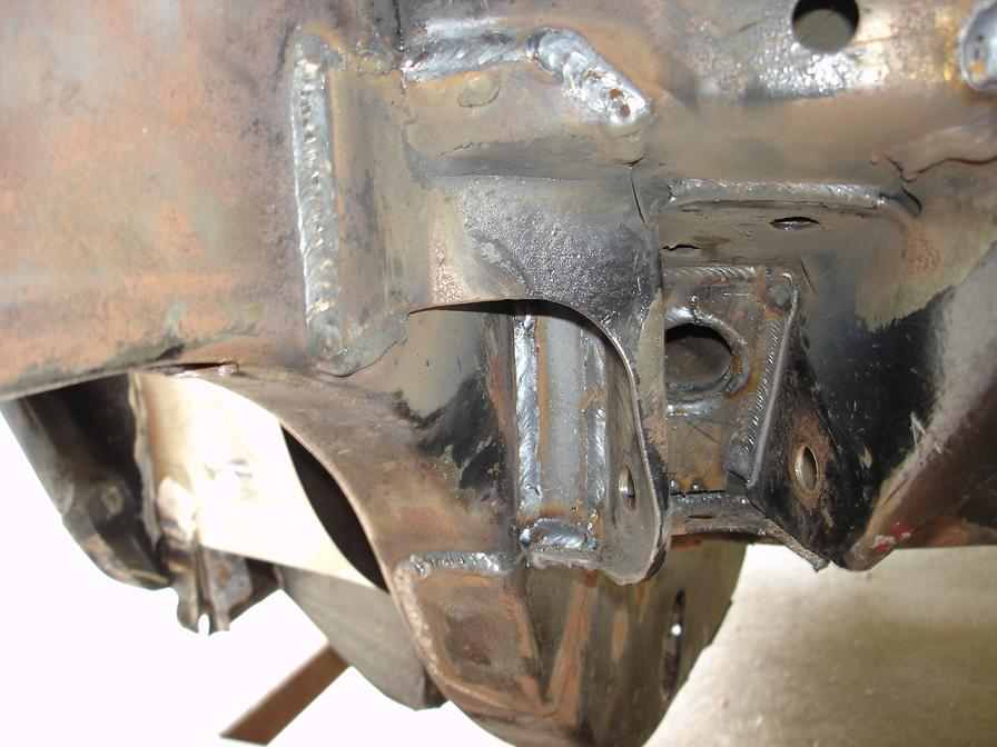

Regardless of what you do, the rear upper and lower control arm mounts are weak. When you start getting the car to hook, those two points can ruin a car if damaged. Make sure they are reinforced.
Sean
This is how my friend did his upper control arm mounts. You can see where one of his roll bar tubes comes into the mount as well. Very sturdy.
