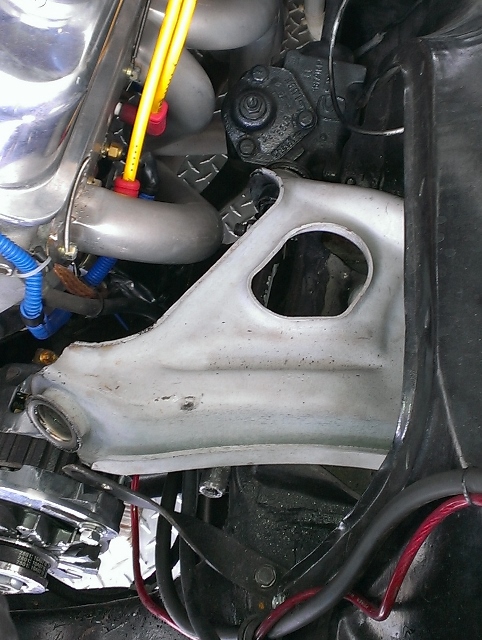

Those bolts are ok. The front end of top a arm bushing bolt either broke, stripped or backed out, and bushing was gone. Allowed the a arm to rotate off shaft. Did not find the bolt, and have not taken everything apart yet to be sure.
I had factory end bolt type setup. Had bolts match marked for easy visual check. Did not notice them lose or moved, but can not be sure.
Here is a picture of the a arm, after I got car back in the trailer... Up on a jack now, but was pulled out when car got stopped. Back of arm is bent around, could not slide the arm back on end of the shaft.

Glad you're not hurt and the damage isn't too severe.
The factory bolts are known for working themselves loose. When redoing the front end on my Nova stocker last Winter, I used these Moog offset control arm shafts and Energy Suspension urethane bushings. They have a large diameter stud and lock nut in place of the small factory bolt.
Global West makes a great setup and Afco has greaseable steel control arm bushings.
