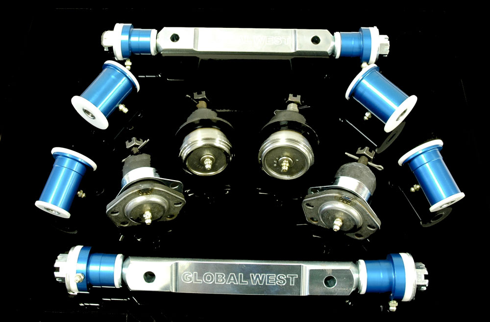

Please excuse me if this is a dumb question. I am building my first race car, with my Dad, and we had a question about the NHRA rule for stock eliminator cars.
Section 10, page 7 states: "Must retain complete stock front suspension system as produced by manufacturer for body used, aftermarket tie rods with Heim joints permitted. Lift kits/travel limiters prohibited. Sway bar optional. SeeGeneral Regulations 3:4."
I don't think that everyone uses stock rubber bushings and I know that racers don't use stock front shocks either. Don't know about what people run for ball joints, but I believe that I want to reduce stiction in the front suspension. That being said would a drag kit like offered by Global West be NHRA legal to run on our 1969 Chevelle?
http://www.globalwest.net/dragracingsuspensionkits.html
Thanks in advance guys/ gals!

Andy,
Yes, you can use the global west bushings and you can even use a longer ball joint such as the ones offered by AFCO.

The global west stuff is nice, but hard to install.... I would go with the greasable afco bushings, that's what I put on my car after talking with greg hill, they are very very free now..

Delrin bushings are nice but the same can be accomplished as a means to reducing stiction with black polygraphite bushings by clearancing the inner sleeve and adding zerk fittings to the outer shell. Longer ball joints than are available from either afco or howe are a must in an effort to gain much needed travel along with the right coil springs. But if you want the best setup, contact Alf Wiebe.
