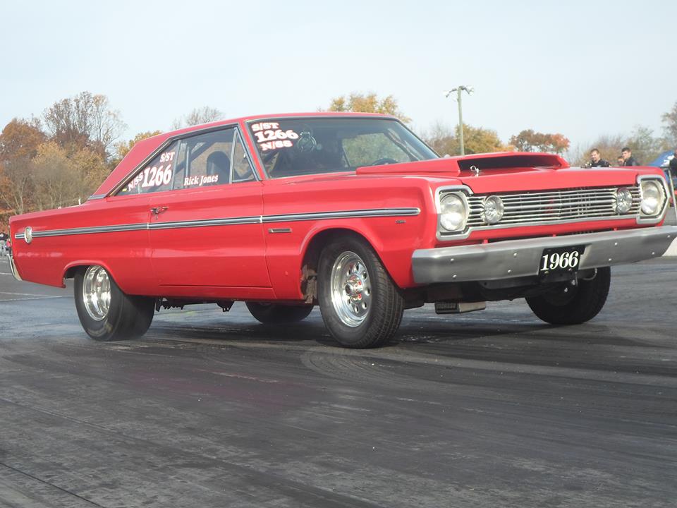

Any Super Class racers use an EZ Plate System? Curious - would like to hear some input if you use it.
