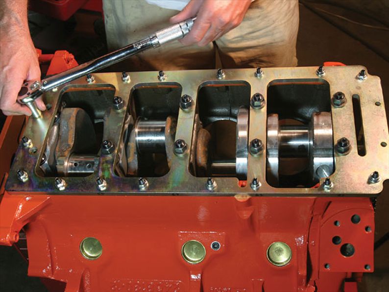

I started to think about when did i start having this problem. I think it is from the Main stud girdle that i put on it. not enough room for the oil to drain back at a fast enough rate. it was probably acting like a second windage tray. now i purchased an aftermarket mega block. so bye, bye stud girdle. What oil pressure would you recommend? i have an adjustable milidon spring set up in the pump. i usually try to limit to 80psi going down the track.

Milodon system run on Steins cars back in the day, never went over 60 # or it would empty the pan.
