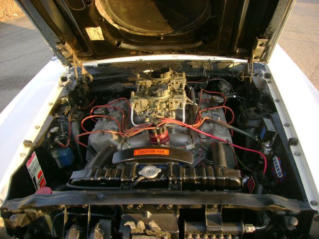

The Boss 429 'Shotgun' did not arrive without it's problems.
The 1969 Boss 429's (first ones out) were 'slugs'.
Engine problems;
Valves too big
Cylinder head port passages 'monster size' worked against the flow
Weak valve springs
Hydraulic lifters
Connecting-rods too heavy
Holley 735 CFM carburetor undersized
* The engines could not rev above 4800 RPM's
Despite claims of 13.50's @ 107 MPH,,,,
Car Life Magazine tested one with 3.91 gears, in July 1969.
Performance Results; 14.09 @ 102.85 MPH.
1969 NHRA Classes; C/S or SS/F.

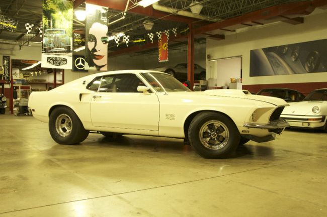

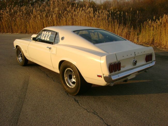

This 1969 Boss 429 Mustang drag car was sent to Tasca Ford in Rhode Island for tuning and upgrades originally.
http://www.bangshift.com/blog/eBay-F...g-Machine.html
