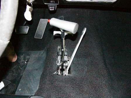

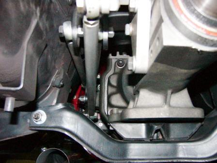

I'd go with the pistol grip over the regular verti-gate. The lever to put the shifter into 1st is easier than the older small T-handle type and the pistol grip with the button on the top is more natural to release than a T-Handle with a button on the side which is what I have now. Both are "inline" shifters.
ID:	6196   Click image for larger version
