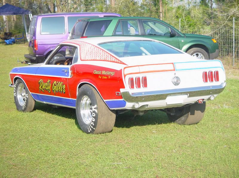

This is the way it looked it 1971
This is current
I can't tell you if it picked up any because when I rebuild it after sitting 20 years I did the Shelby drop before I raced it.

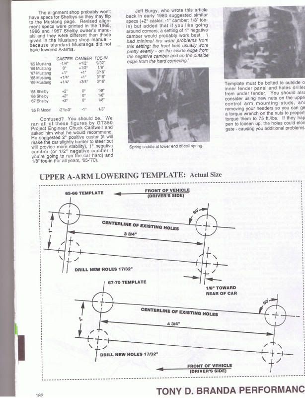

Rusty,
Where can I find some details on the 1" drop?

Opentracker Racing Products has a template and this is from Branda's catalog.
