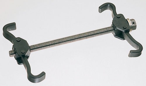

I used a compressor like this, removed the hook by the bolt head, and put a round plate there, the other hook was hooked into the spring, then I ran the threaded shaft thru the hole in the control arm with the bolt on plate under the arm.
