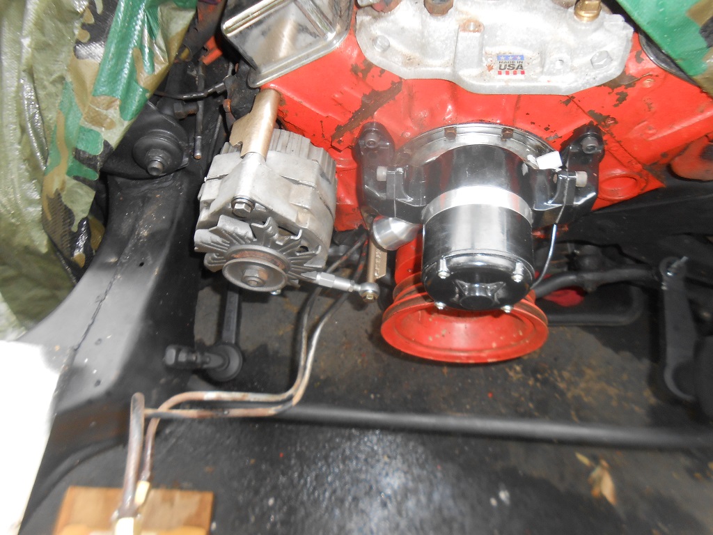

Test fit and fabrication of alternator relocation mounts, Front and rear bumpers backside and inner mounts/braces were very rusty, wire wheeled them, treated with naval Jelly, painted with rustoleum. A LOT of work but didn't want to be dropping rust all over the track. The rubber bumper ends were coming off, so made aluminum end caps to hold them in place. Finished mounting master cylinder and line lock. NOTE - 75 - 79 nova brake pedal arm for power brakes differs from manual, push rod/clevis hole location is way different, there are NOT 2 different holes like the older Novas. You have to drill a new hole for the pushrod/clevis and make your own rod and clevis unless you can find the stock pieces in a wrecking yard. I found a picture on a Nova website he helped me locate the new hole, modified a rod/clevis kit from Speedway.
