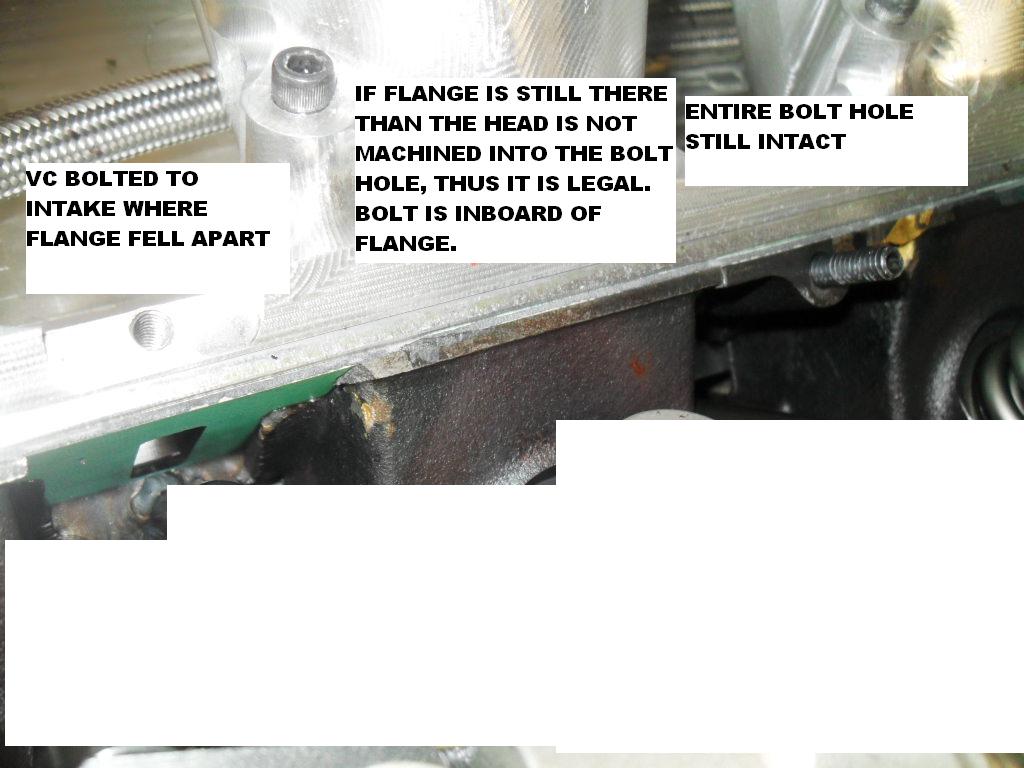

I don't know why everyone keeps saying the original rule was to not cut into the top of the valve cover bolt hole. If it said anything about the valve cover bolt hole it would have meant cutting into ANY portion of the hole.
Where did it ever say you can cut into the hole but not on the top?
Anyway, besides all of that, Charlie, I have 2 simple questions for you.
#1 - At Indy 2012, did you go to teardown with your valve cover flange busted off?
#2 - At Indy 2012, did you have external modifications to the front of your heads like Comella had at the Dutch Classic?
According to the picture posted on Moparts, your valve cover flange has been machine so much that the flange is falling off. What good is the top of the hole if the flange is gone? And the one crappy repair you can see that the flange was poorly welded on and is clearly not welded back in place where it should be.
Wendell Howes stated that everyones valve covers should bolt onto each others heads. We clearly showed him as well as NHRA that you can still bolt on a factory valve cover to our heads with all 10 bolts. I can't say the same for yours being you have to bolt your valve covers to the intake! Can you say bogus?
I wouldn't have the balls to show up at an NHRA event with parts like this. I have too much respect for guys like Dave Ley and Ryck Cambell. I couldn't look them in the eye with a straight face and say my parts are legal. I don't know how you sleep at night.
