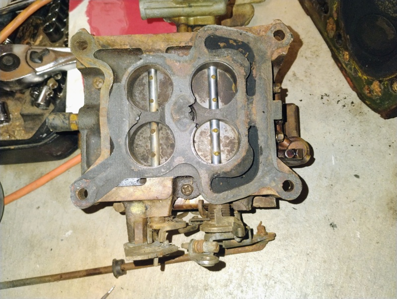

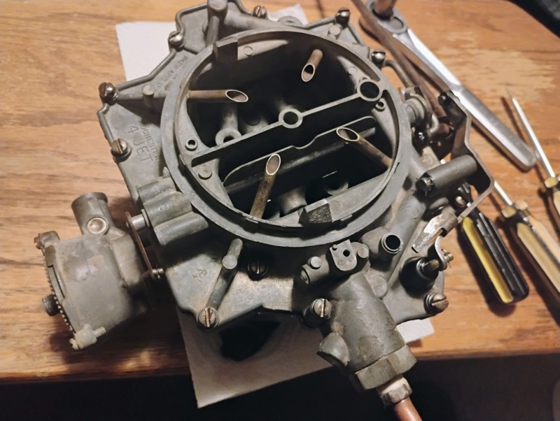

It's original off a 59 Vette. The primaries and secondaries are the same size so I'm thinking it's the smallest version? The reason I ask is I was trying to build an engine for the Vette that looked completely original and stock but it'll be a hopped up 400ci. 10:1 compression, ported 2.02 041X heads, 230ish cam @ .050. The 400 will probably make peak power about 5500rpm so if the carb can even get close to that I'd be happy. But if it's going to stall out at 4500rpm that's probably not going to be worth trying out.
I just finished a full rebuild lastnight
Attachment 73089
And here's a pic of the primaries and secondaries if that helps determine which carb it is
Attachment 73090
Mark Yacavone 07-23-2025 10:28 PM
Re: Rochester 4jet 4GC capability
The 59 is the smallest.
The 65/66 PP is a bit bigger.
What you want is a 340 hp 409 carb.
I don't think they had the filter up top , but that top you have will fit right on it. ;-)
