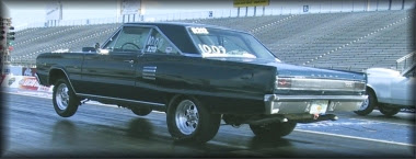

I have a '66 Coronet setup like Stocker expect with 493" 13.0cr power plant and glass hood. It's been a few years since I've had this combo on the track, but have 450+ passes in the car. It has QA1 Double Adjustables up Front, CalTrac Leafs, Rancho 5-Way Rear and CalTrac Bars. I have 5" of range in front with .840 T-Bars. PTC 9" @ 5200rpm. I've ran it with ATI 8" with better short times. Last time out, I went 9.93@135 with 1.404 60' at ~800DA on 94"circ Hoosier Radials C06. That was almost 8 years ago! I always used Hoosier Radials because the section width is the only one that will fit the fenderwell with some custom spacing. I got an easy 125 passes out of the last set, but that's when they were $199 a piece! Last time I ran BIAS, I only got about 75 passes before the sidewalls were mush.
My question to you guys is simple. Do I go back to the C06's or C07's on a 3650# car? Any changes over the last few years in tire tech? I'll be mainly bracket racing at Gainesville, and nearly all 660'. I really don't want to buy from a warehouse (JEGS or SUMMIT), and our local guy only handles MT, or I would buy from them. Last pair i got from a warehouse looks like I got one new one and one that had been collecting dust for a few years. Any help appreciated!

Those aren't too bad short and I can afford the rpm at the end. I ran the 18160D07 before, but the sidewalls get weaker by the day after about 75 passes. I hate running tubes, but if I did run that tire, I'd have to consider tubes to ensure I was able to get better sidewall life.
11.5 section width is all I can squeeze for now. I can get closer to 12" section width if I stretch the inner fenderwell some.

Like Myron, I run the Hoosier 9.0/30.0R-15 (94")... I have tried both the C06 and the C07 compounds... My 60' times were the same (1.40 area) but I got about 20-25 more passes with the C07's so that is what I run. My car weight with driver is 3540..

Thanks Guys! The C07 seems to be the best fit from all the responses and phone calls I've made. I appreciate all the positive input!

C07 were the ticket! Decided to put the 8" ATI Converter back in as well since were mainly 1/8th mile around here.
Pass1----Pass2
0.038-----0.031
1.425-----1.420
4.092-----4.088
6.381-----6.374
106.83---107.12
Ran 'em at 20psi with 2 Sec Burnout. Left off footbrake at 2000rpm with 26" tires up front. 2100-2200' DA with reasonable track conditions. I feel like we can get a 1.3x 60' and sub 4.0 330' in right conditions and a few more tweaks. The 6.35 I'd ran 8 years ago was on stellar track and a 450' DA day.
