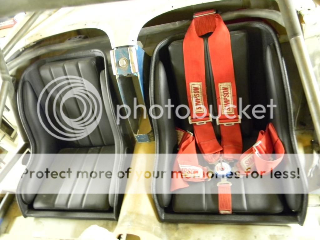

I made the seats to provide maximum driver comfort in the small Corvette interior.
http://i48.tinypic.com/mr61kk.jpg

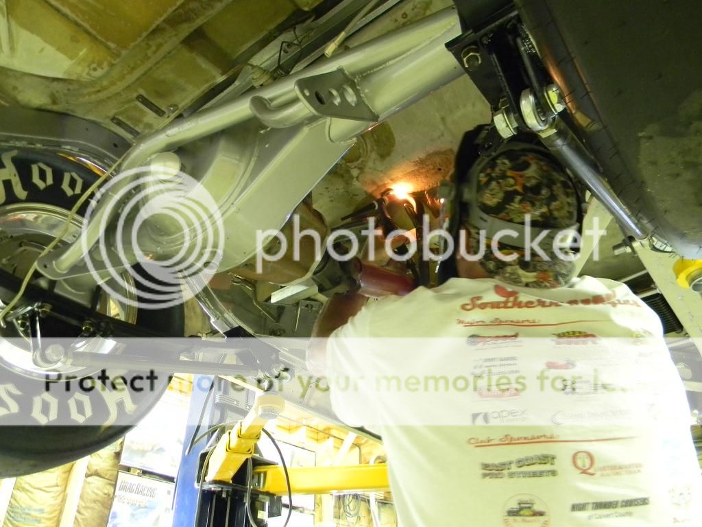

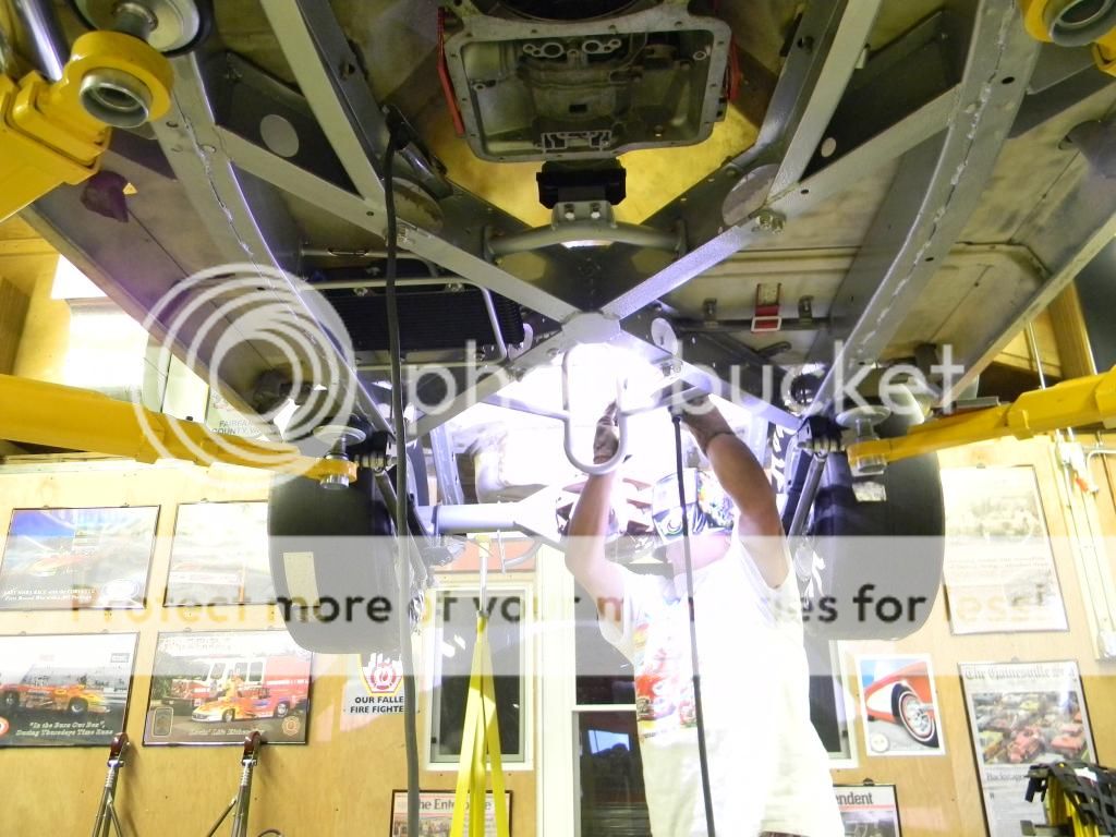

Wade Mahaffey 03-20-2013 06:56 PM
Re: 58 Corvette RACEtoration is back online!
Had the Corvette frame on the lift today, so I got a few shots of the rear suspension detail.
http://i49.tinypic.com/4lhjrs.jpg
This is my modified Caltrack set-up. I am going with the leaf spring because of the amount of street driving I'll be doing. The race four link and ladder bar suspensions don't like torsional movement.
http://i45.tinypic.com/30l06eq.jpg
Trans cooler detail is between the main frame rail and the "X" brace
http://i47.tinypic.com/34g10mt.jpg
Trans mount detail and removeable "X" brace portion needed drop the trans
http://i49.tinypic.com/2111h92.jpg
http://i45.tinypic.com/2mighs.jpg

Rory McNeil 04-15-2013 02:03 AM
Wade, nice work, but are you sure there is enough room for the CalTrac front bracket to rotate before it contacts the frame? It looks pretty tight in the photo.
Rich Biebel 04-15-2013 07:58 AM
I think the car is on the lift and the rear is hanging down. That puts the brackets in a place they will not be once the car is sitting on the springs.
Wade doesn't usually miss much on his work.....
Wade Mahaffey 04-15-2013 07:29 PM
Rich, you are correct. The spring arc will be allmost straight at static position. That will pull the CT bracket reward gaining clearence in the front. But it's nice to know that some folks on here actually look at the stuff. I think I have it covered LOL, but I never say never. I have some other stuff to share, but I have sent it to NHRA for compliance verification. Hope I did'nt make a mistake by asking for permission instead of begging for forgiveness like alot of other folks do. The last time I did this they changed the wording in the rule book....not for me, but because I pointed out how many (not who)were in violation of a current rule in the book. Now the new wording brings those in question into compliance....

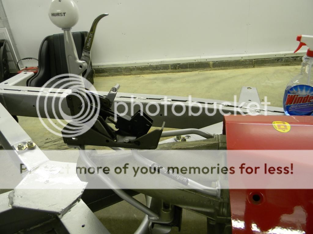

This is the first time the car has been on the chassis since it was separated a few years ago. It has stock front suspension where a straight axle suspension once was. And now a 9 inch ford rear where an Olds rear was. I'm happy with the project and I know it's happy LOL
http://i444.photobucket.com/albums/q...s/DSCN2414.jpg
The shifter mounted on the trans is cool. It will allow faster converter changes during testing with quick disconnect fluid lines. The hole in the tunnel is large enough to allow the trans to move reward and then straight down....quick change the converter then back up in place. If you need to change out the trans, you can move the shifter over while the trans is on the bench where it's nice and easy. When I switch over to manual transmission, I don't have to deal with the shifter mounted to the floor. I want to have the stick and street engine able to swap out for the race application 283/glide. I'll be fabricating a two piece cover for the hole
http://i444.photobucket.com/albums/q...s/DSCN2415.jpg

Wade Mahaffey 08-31-2013 01:49 AM
This is my fabricated shifter detail. The 1/2" chrome-moly tubing in that configuration is extremely strong and concrete firm. It simply bolts up using the shifters pre-drilled mounting holes
http://i444.photobucket.com/albums/q...s/DSCN2387.jpg
Wade Mahaffey

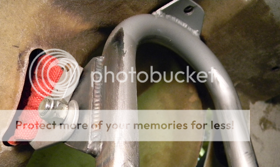

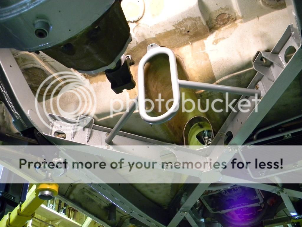

Wade Mahaffey 09-18-2013 07:48 PM
I got the driveline loops done today. I wanted the body on the frame when I fab'ed up these things (with a shaft in place) in order to provide perfect placement. The front loop is way up in the tunnel made of 1/4 X 2 flat steel, and is a glove fit because of the lack of room. The rear loop is 1" X .095" chrome-moly and TIG welded. It's removable just in case a chrome shop wants to give me a little break on chrome work. LOL
http://i444.photobucket.com/albums/q...s/DSCN2462.jpg
http://i444.photobucket.com/albums/q...s/DSCN2465.jpg
Wade Mahaffey

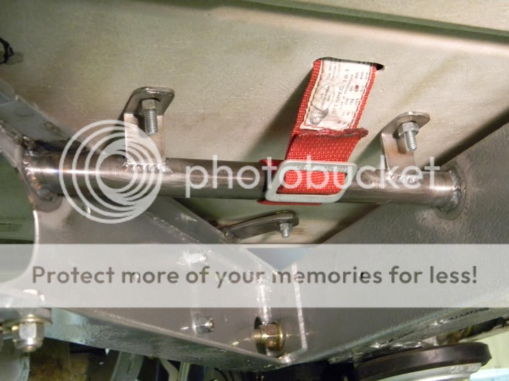

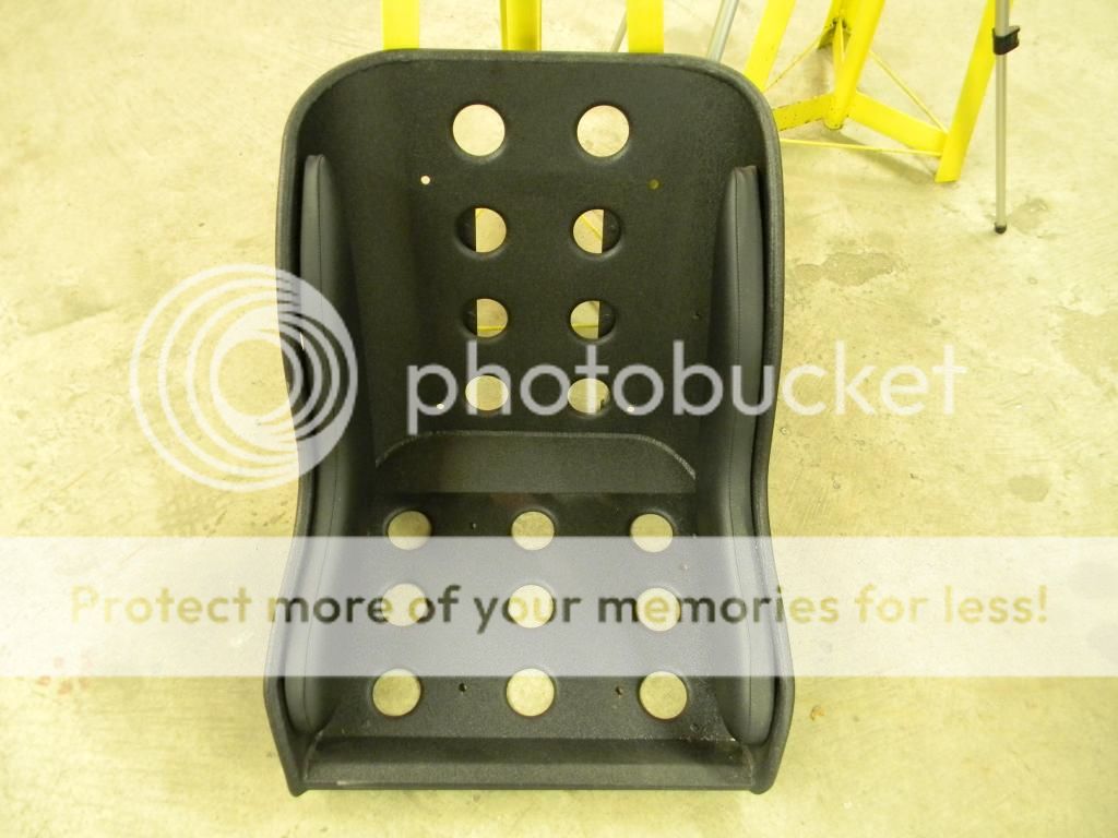

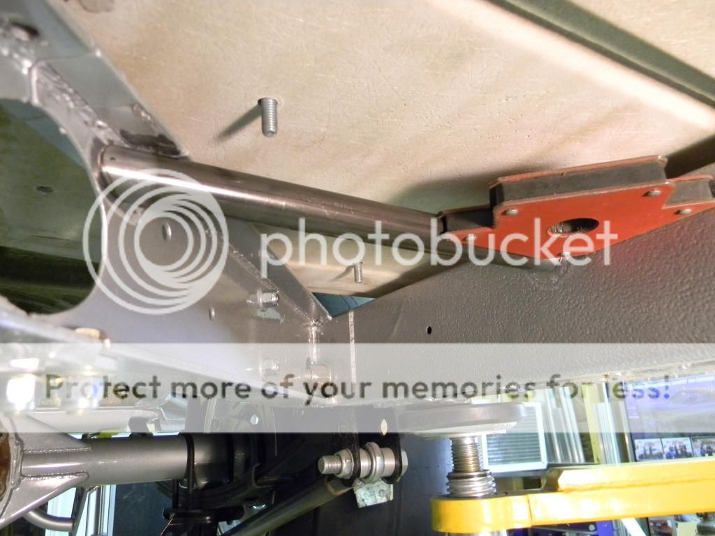

Wade Mahaffey 09-29-2013 11:07 PM
Working on the seats and driver restraint system mounting points. The first thing I did was locate the seat in the car for maximum driver comfort. Then holes were drilled through the seat and floor. There are no mounting provisions for aftermarket aluminum sheetmetal seats in these old Corvettes as you can see
http://i444.photobucket.com/albums/q...s/DSCN2468.jpg
I welded a piece of 1" X .095 Chrome-Moly tubing in place as a cross member. This provides a structure that would be suitable for the seat mounts as well as the "crotch strap" mounting point.
http://i444.photobucket.com/albums/q...s/DSCN2476.jpg
http://i444.photobucket.com/albums/q...s/DSCN2483.jpg
I had to come up with a mounting point for the inside lap belt (closest to the drive line tunnel). So I welded tabs to the drive line loop cross member. The cross member loop also attaches to the body at the top of the loop for additional support. Note: This belt is an old belt and not correct for this type of anchor design, and only used here for visual mounting alignment.
http://i444.photobucket.com/albums/q...s/DSCN2480.jpg
http://i444.photobucket.com/albums/q...elineloop2.png
I made the seats from .080 aluminum sheet in two pieces. The bottom is completely welded to the wrap around back and sides. 1/2" round aluminum stock is then formed and solid welded all the way around except across the front bottom. The seats were then powder coated in black wrinkle finish. Four panels make up the seat interior (the bottom, back, and two "L" shaped sides)
http://i444.photobucket.com/albums/q...s/DSCN2481.jpg
http://i444.photobucket.com/albums/q...s/DSCN2500.jpg
