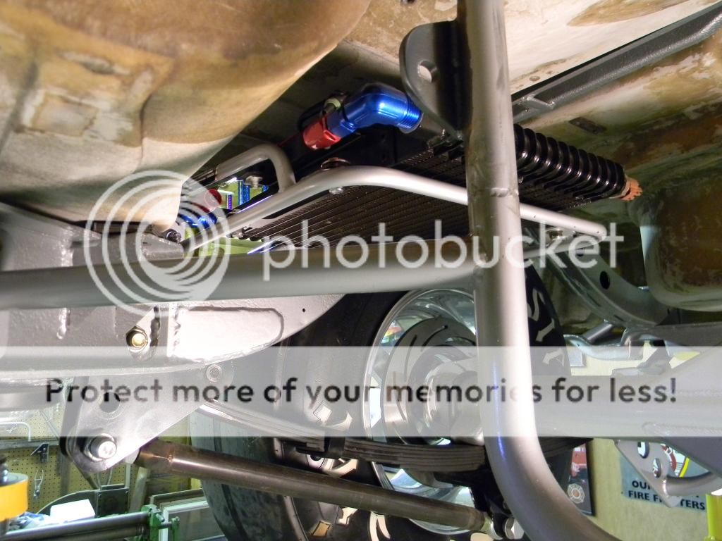

After some re-evaluation, I have decided to re-locate my transmission cooler. It was very nice and tucked away in between the right frame rail and the "X" cross member.
http://i444.photobucket.com/albums/q...s/DSCN2495.jpg
The problem with that location was that it would/could hamper a transmission or converter change operation. The new location also allows hot air pulled through the cooler to vent into and through the rear wheel well area. There are a few other considerations that offer an advantage to the new location.
http://i444.photobucket.com/albums/q...s/DSCN2509.jpg
http://i444.photobucket.com/albums/q...s/DSCN2510.jpg

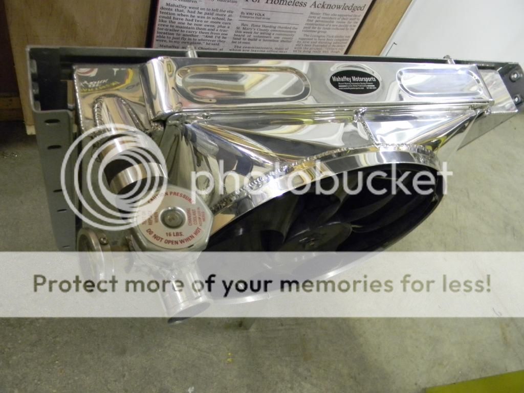

This is my cooling package. It uses a Flex-a-lite 3300 CFM electric fan. The hand formed aluminum transition was fabricated to maintain the factory correct radiator laid back angle while the fan angle was straight up and down, as stock. It fits in the stock core support very nicely, and closely resembles the stock unit.
http://i444.photobucket.com/albums/q...s/DSCN2523.jpg
http://i444.photobucket.com/albums/q...s/DSCN2518.jpg
