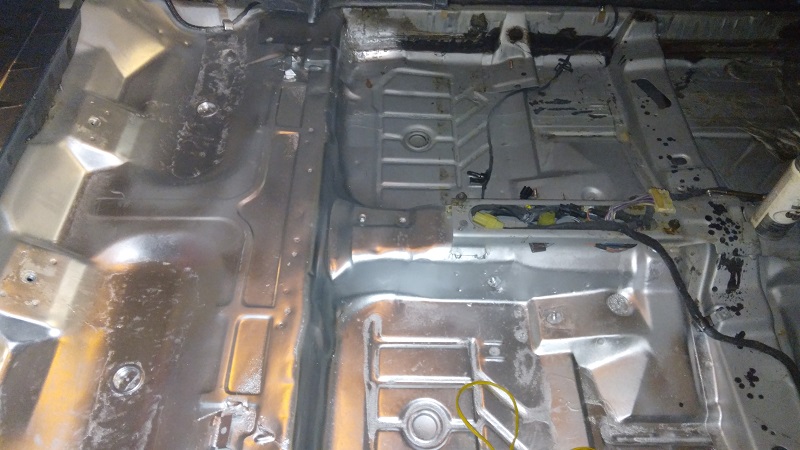

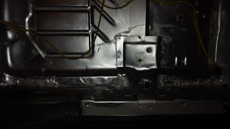

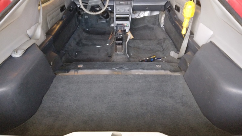

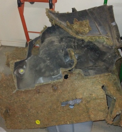

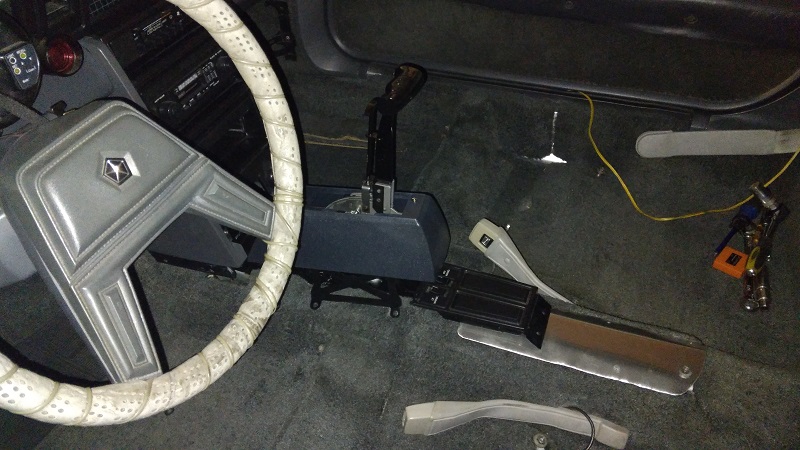

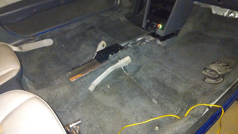

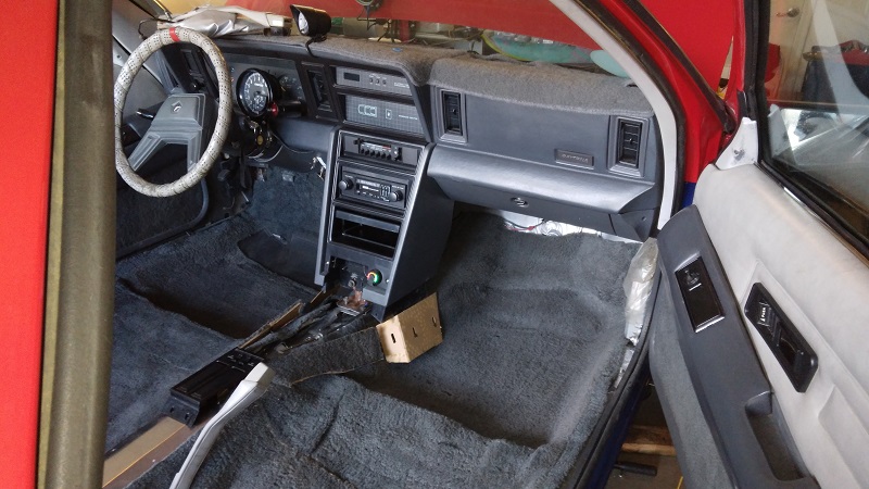

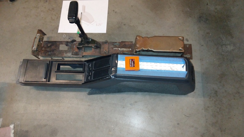

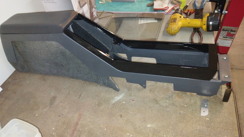

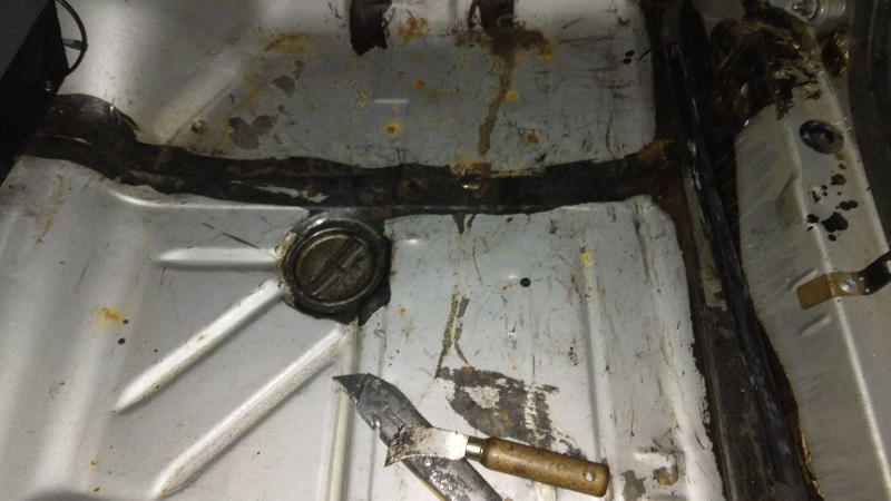

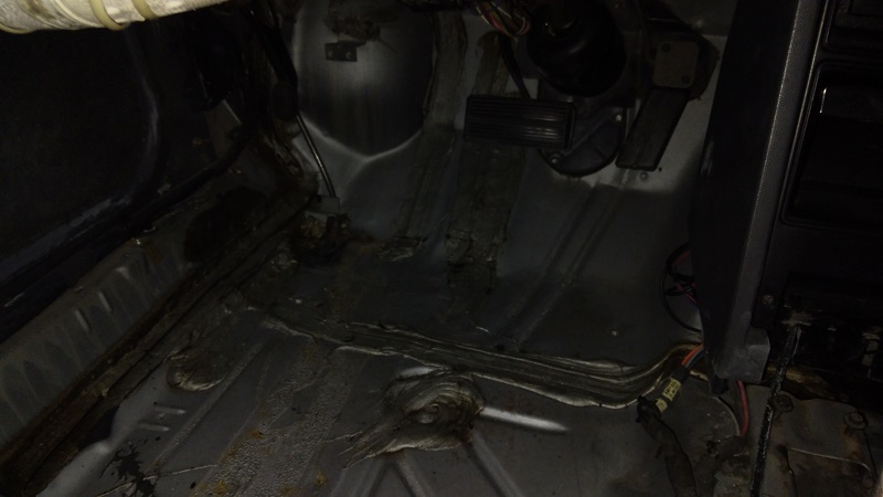

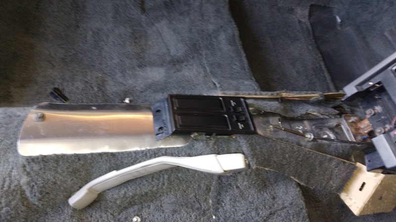

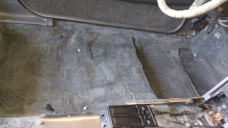

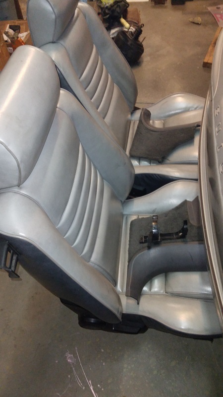

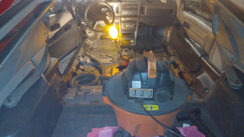

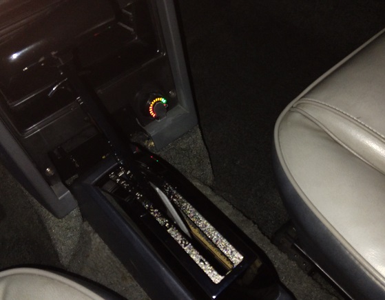

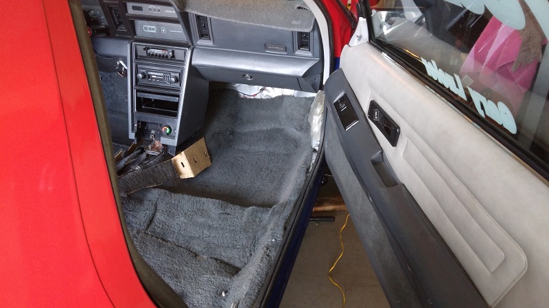

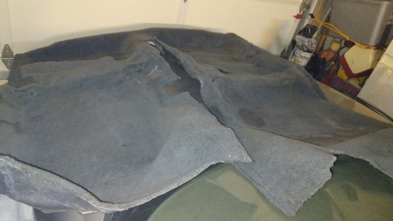

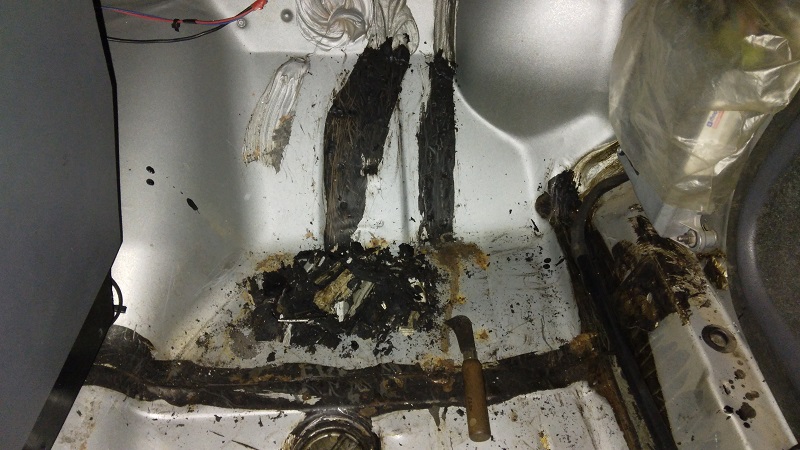

Cglrcng 05-01-2024 09:22 PM

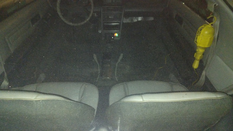

Re: A 30 year journey, and a 2nd chance.
6 Attachment(s)

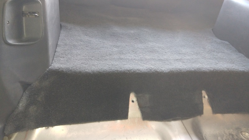

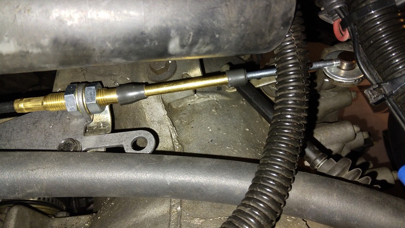

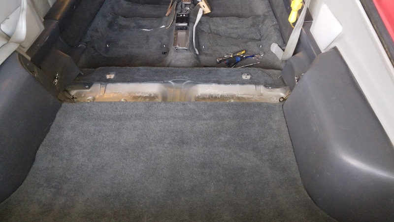

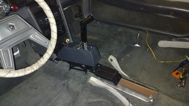

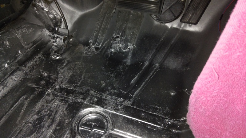

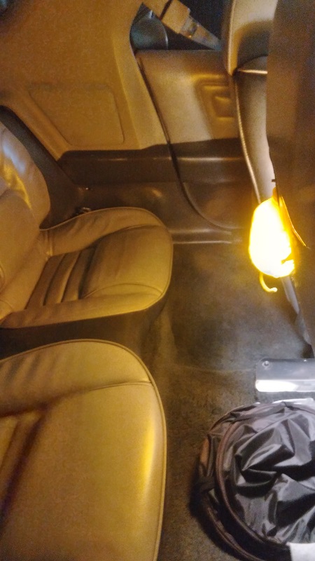

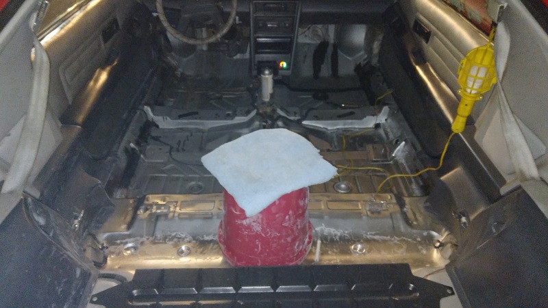

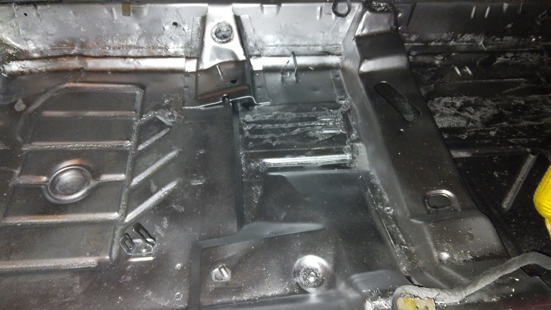

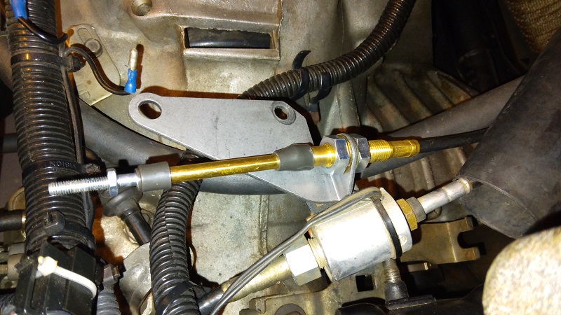

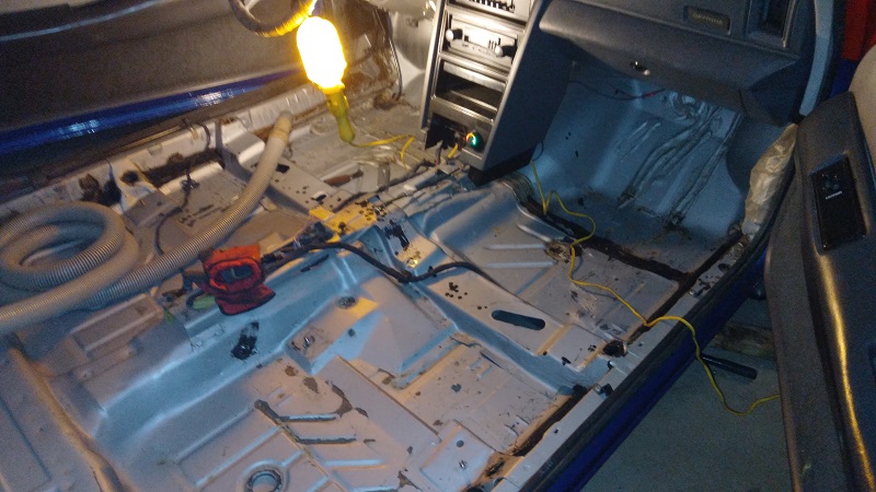

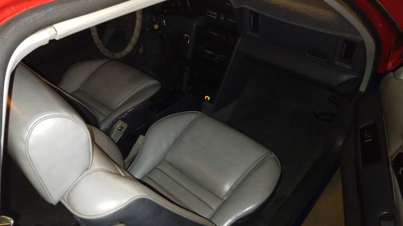

Almost net 100 lbs. removed just from under the carpet, and I still have probably another 20 lbs. alone up both sides on the firewall, that I can remove another time (I flat got super cramped and tired of scraping up the firewall under the dash, pedals, etc., so left the rest above the carpet line.
My math (on paper at least), at this point said w/ the empty 14 lb. weight box/torque strap combo, still inside the engine bay (So I can adjust wt. later), that I was going to scale about 20 lbs above the DF/S min. wt..
Time to install the carpet, shifter mount and new shifter, and make some adjustments to the console to slide over it and remount in the future (if going back to EF/S later I will need that weight), just thinking ahead as dropping the weight also requires it to run .95 seconds faster just to make the DF/S Index, and with the stock ECM/PM at elevation would still be a miracle 345 lbs. lighter (I don't care how far under it can run at Pomona (or any near sea level track), I am stuck w/ the lousy elevation and ever worsening DA (corrected not enough at even +3/10ths), of Las Vegas being my home track, Phoenix next closest, then Pomona, and Bakersfield, Sonoma, etc....On to the shifter install, replace seats and the rest of the interior trim.Attachment 69848
Attachment 69849

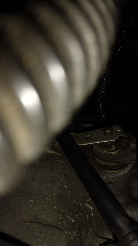

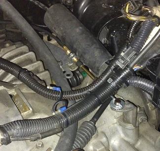

Cglrcng 05-01-2024 09:30 PM
9 Attachment(s)
Attachment 69854
Attachment 69855
Attachment 69856
Attachment 69857
Attachment 69858
Attachment 69859
Attachment 69860 I dropped out 2 dozen engine bay and pics here so as not to bore those reading the thread, as it took 2 bracket installs to get it just the right angle so it was really smooth shifting, and adjusted perfectly.
Attachment 69861
Attachment 69862

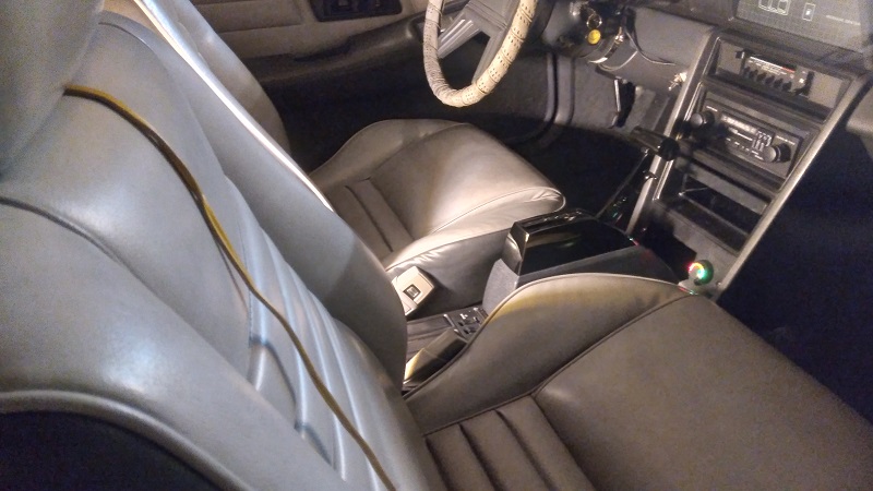

Cglrcng 05-01-2024 09:41 PM
8 Attachment(s)
Attachment 69863
Attachment 69864
Attachment 69865
Attachment 69866
Attachment 69867
Attachment 69868
Attachment 69869
Attachment 69870 Next up the Console fabrication adjustments, will it fit over the top, yes, but needed the Auto Window switch plate completely shortened & reworked. And it was a battle (but I later got it to fit over the new shifter base and mount, more on that after DF/S testing).

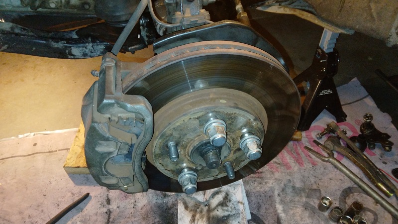

Cglrcng 05-02-2024 12:06 AM
9 Attachment(s)

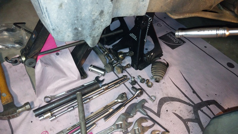

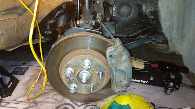

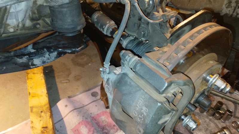

Attachment 69883 Not pics of the brake hoses replacements I did to my race car, but I replaced all the front end parts on a neighbors Toyota van (Upper and Lower Control Arms, Ball Joints, Inner and outer tie rods, etc.), just as soon as that job was out of the garage and headed for the alignment shop that required his replacements before he would/could align it...I pulled back in my car and since I already had the tools and materials out I did my new brake hoses, flushed and bled them again. But, I was so tired at that point I forgot to take pics of The Daytona work. Lol.
Attachment 69884
Attachment 69885
Attachment 69886
Attachment 69887
Attachment 69888
Attachment 69889
Attachment 69890
Attachment 69891 Ok, now the Stocker is in DF/S trim, I calculate d it was within 20 lbs of min wt. for the class w/ me and my helmet in the driver's seat, And readied the car for Div.7 1-2 Double, arranged transport and storage in Chandler , and to and from Phoenix, then Las Vegas (including Storage about 8 miles from the Strip at Las Vegas Speedway (right off the Strip), started working on the Race season Schedule....Then the wheels came off and I ended up with Covid and in the hospital.

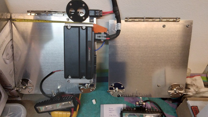

Cglrcng 05-02-2024 09:18 AM

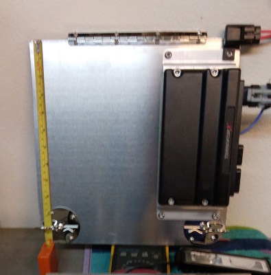

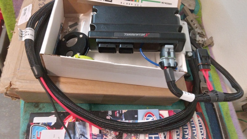

Next up, a Holley EFI System & Harness w/a wide band 02, a 2 Step, convert the brakes to manual, get that converter loosened to 5,000 & refresh the Transaxle while it is out (as those bands and clutches are the 1984 originals), and get the cam I started the car with a year ago (or 1 like it and updated closely with it to today's technology back in the car). If I am going to risk screwing up a decent thing to go faster, we might as well go all the way. At least I know it is a good starting point, the turtle can run 8 tenths under, just not at Las Vegas. (-134 under a factored index on a 17.61 dial in in EF/S (17.75), against a -726 under 9.65 dial in in FS/C (10.47), just does not feel that comfortable at the outset, but it can be very rewarding if the car does its job, and you do yours). Dead 6 will put a big smile on your face...And followed by Dead 0-in the other lane, a round later can take it away too!
It's all fun and games I would not trade for anything right now, even when it was the struggle bus.
Then there are other considerations, wheels, tires, bearings, brakes, alignment changes, etc....all in good time.
So, most of the plans I had last Winter at least for the car, are still the plans I have again now. With all that completed, we will again later attempt to test it in DF/S trim again. Until all is, I wouldn't even for kicks attempt it unless it was a sea level track. The California Car, just loves California air. It liked FL, air, and Houston Air too though.

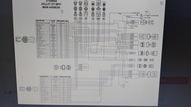

Cglrcng 06-12-2024 05:10 PM
I will be using an un-terminated 15' main harness to create a custom harness (Using the Universal MPFI docs as a guide), as they don't make a terminated harness for the 84 Daytona 2.2L/135 CI Single point TBI.
