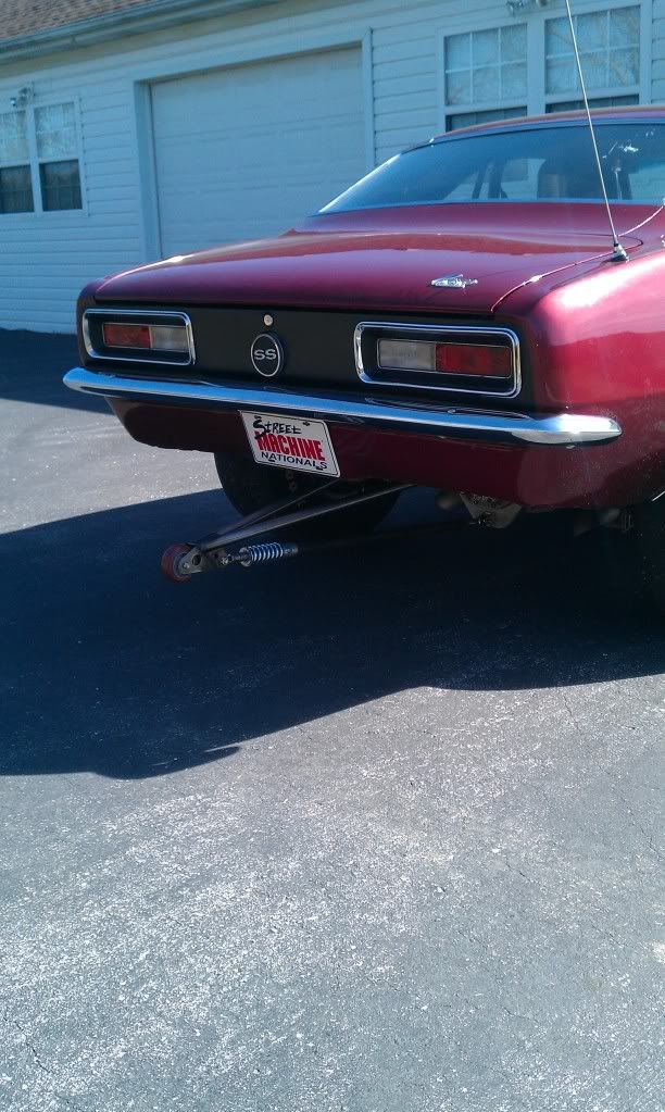

Calm that thing down ......and put a wheelie bar on it.......guardwalls and sheet metal don't mix well........and oil pans don't usually look good if you bail out of one of those big wheelies.....
40Coupe 03-07-2012 08:48 AM
Re: Front springs
No kidding!
