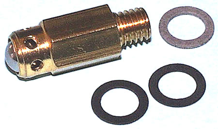

SSDiv6 10-07-2008 11:06 AM
Re: motorcraft 4300 carb info
Originally Posted by Tom Goldman (Post 86110)
Jeff, the problem with 7# and up of fuel pressure only is an issue when running the oem style secondary needle and seat. ....Not an issue when running only a larger primary needle and seat. .....Tom
In the past, I have used the Grose-Jet needle and seat assembly which allows you to run higher fuel pressures without flooding the engine.
They are similar to this picture:
http://www.minimania.com/imagesbig/aud9096gr.jpg
I cannot remember if Jeff Lee tried them ion his carburetor in the past. I have succesfully used them in many foreign car applications, Quadrajets and Webers, allowing me to run higher fuel pressure without overriding the float.
